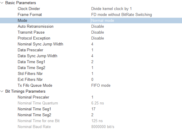

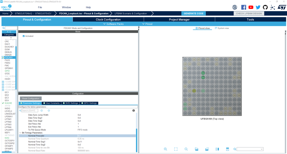

Diane POMABIA
@mk.1ashin​
Please find this configuration that give you FDCAN with baudrate at 8MBits/s.
_legacyfs_online_stmicro_images_0693W00000bkeyaQAA.pngRegards
Diane

LCE
Principal II
I think Cube forgets to enable transceiver delay compensation, which is vital at that bitrate.
Anyway, "nominal" bit rate is for arbitration phase, which must not be faster than 1 Mbit/s, I think.
LCE
Principal II
So you have to enable FD mode with BitRate Switching.
Then set "nominal" timing to max 1 Mbit/s, then "data" timing to 8 M.
Have you checked the U575 spec if its FDCAN can run with 160 MHz clock?
I just know the H7's, which has a limit of 100 MHz.
