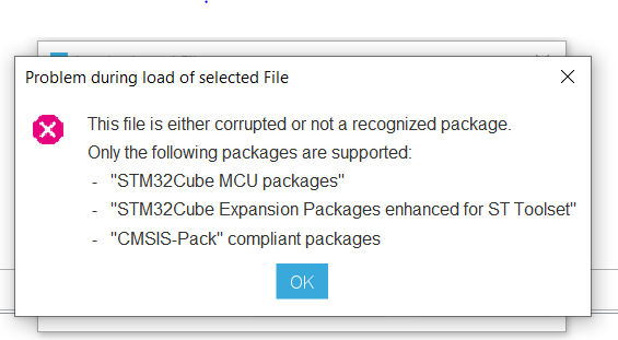

in https://www.st.com/content/st_com/en/products/embedded-software/mcu-mpu-embedded-software/stm32-embedded-software/stm32cube-mcu-mpu-packages/stm32cubef4.html there are the MCU package and the patch, the first can be installed from CUBE IDE with "manage embedded software packages" but when I select the second the tool says that is not a compatible file

Hi, I already had installed (using the "from local" option) the stm32cube_fw_f4_v1270.zip, but when I chose the patch (using the "from local" option) I got this error:I just have downloaded both files using the "manage embedded software packages" and let cubeide automatically detects there is a new version (patch) and install it, now works

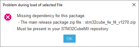

Hello @jg_spitfire​
While reproducing the issue you encountered I had the following issue when installing the 1.27.1 patch:
If this is the issue you faced, you can follow this steps:
- Rename the FW .zip file downloaded with the correct format "stm32cube_fw_f4_v1270.zip"
- Copy that file to the STMCube repository
- Import the patch file with the Package manager.
Kind regards,
Semer.
