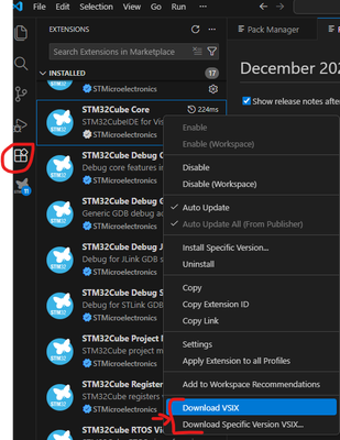

All dependencies are available here:
To download them:
If you are taking time to exercise keep us posted about result !

And then install it like that:
It works! Thnak you:)
