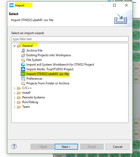

Hello @SKris.1616​
To import a project into STM32CubeIDE which is generated by STM32CubeMX, try to follow the next steps:
  1. Open CubeIDE v1.2.0
  2. Go to File => Import => General => Import STMCubeMX.ioc file0690X00000Bwc2PQAR.png
Best regards,
Nesrine

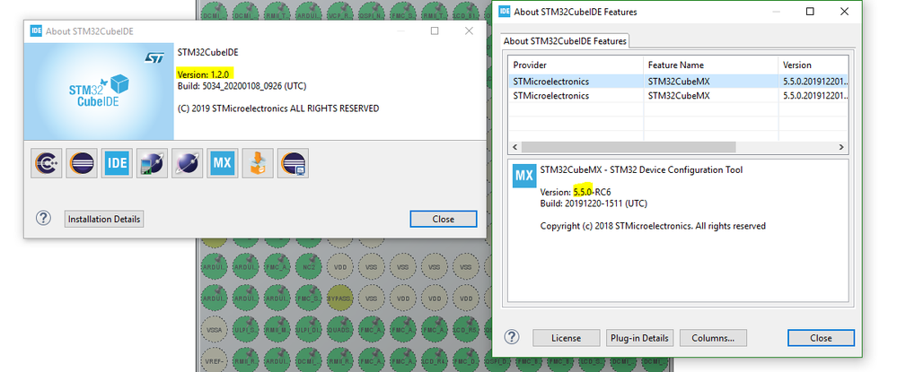

Hi @SKris.1616​
Please try with the lasted version of STM32CubeIDE (1.2.0).
