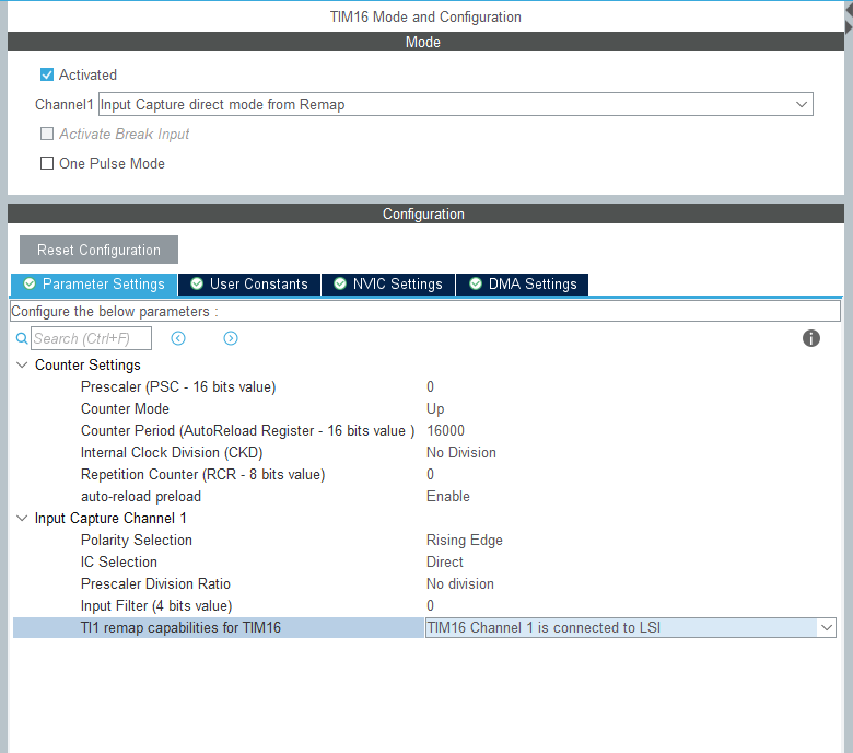

Try as I might in the STM32CubeMX I can't get TIM16 to use the LSI as the input.
MX_TIM16_Init();

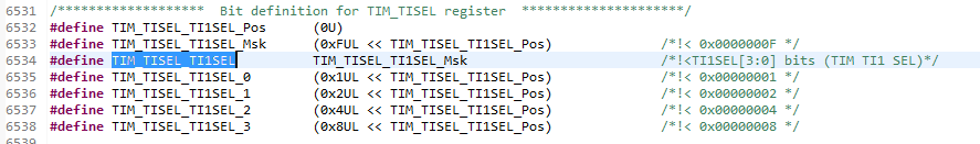

 HAL_SuspendTick();
 HAL_TIMEx_TISelection(&htim16, 1, TIM_CHANNEL_1);
 HAL_TIM_Base_Start_IT(&htim16);
The call to HAL_TIMEx_TISelection() ends up performing this write to the TISEL register of TIM16
MODIFY_REG(htim->Instance->TISEL, TIM_TISEL_TI1SEL, TISelection);

Here is my STM32CubeMX setup.
0693W00000NpWQjQAN.pngI am expecting roughly 1/2 Hz interrupt with a 16000 setting. Instead, I am getting 1mSec.
Any help is appreciated.

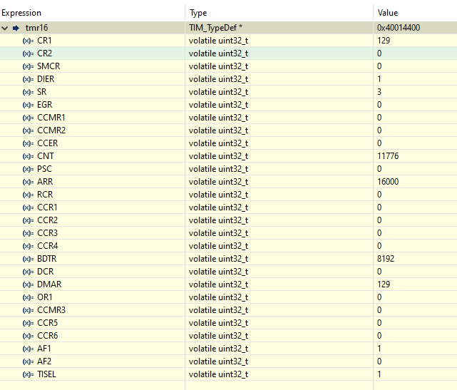

waclawek.jan
May 7, 2022
Read out and check/post TIM16 registers content.

I think I found my own answers. None of the timers can be clocked by the LSI. You can measure the LSI by using it as a gate for the counter, but not to drive the counter. Drat.
waclawek.jan
May 8, 2022
Indeed, TIM16 does not have the slave-mode controller so you can't use TIM16_CH1 as source for external clock mode.
The TIM15/16/17 chapter is confusing in that TIM15 has a different structure than TIM16 and TIM17 and I've looked at the wrong diagram (in RM444 the TIM15 block diagram is placed into the TIM16/TIM17 main features chapter...)
You still can use LSI as input clock to LPTIM or RTC.
Please select your post as Best so that thread is marked as solved.
