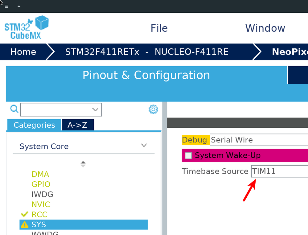

Hi !
I need to overwrite the "normally" weak defined generated function HAL_TIM_PeriodElapsedCallback().
But if a timer other than SysTick is used as Timebase Source (which is recommended when FreeRTOS is used) than STM32CubeMx is generating this function directly in main.c without the weak property.
Therefore I'm looking for a macro or definition which can be used at compile time to know which timer is used ...
Thanks !
Michael.

This setting can be found in .ioc file.​ Use a text editor to inspect the ioc file
Katzenberger.Michael
July 27, 2020
That's true but this information must be provided to the gcc compiler somehow - too much effort writing a tool for this ...
