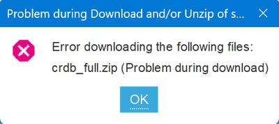

how to deal with this error?
error downloading the following files: crdb_full.zip
‎2023-05-06 1:52 AM - edited ‎2023-11-20 6:15 AM
I get this error in downloading files in side stm32cubemx:

‎2023-05-08 12:02 AM
Hello @MJavi.1​ ,
Did you trying using CubeMX with admin right?
Please have a look at this post, it may help you.

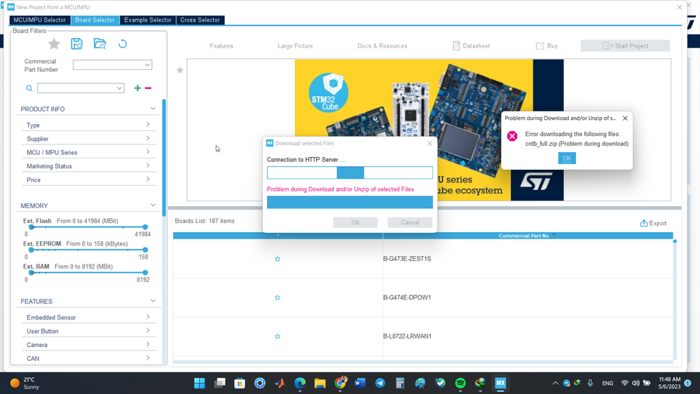

‎2024-06-15 2:17 AM
Sorry, I am running as an administrator in version 6.11.1 of STM32CubeMX, and in Start My Project from MCU
This error still occurs when ACCESS TOMCU SELECT
‎2025-02-18 6:48 AM
Hello!
I think you have fixed the problem by now. But maybe someone who has the same problem will be interested.
I had a similar problem when I tried to install the SMT32G474 package.
After I moved the folder for the firmware repository from my user directory to a general directory on the C disk, the problem no longer occurred.
You can find the settings under: [Help/Connection & Updates] and the [Updater Settings] tab in the dialog.
In the [Firmware Repository] section, I set the directory to
C:\Local\Tools\STMicroelectronics\STM32Cube\Repository
But all other generally accessible directories without spaces(?) should work.
It was then possible to install the packages.
