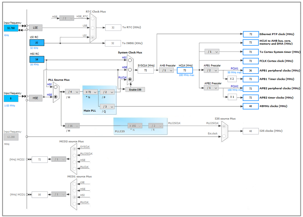

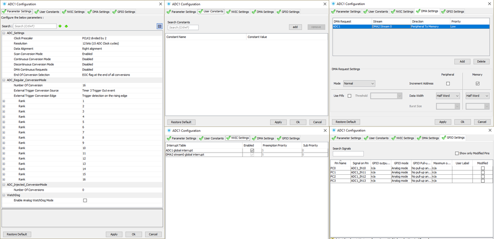

The most important setting in CubeMX:
In ADC every rank have 3 cycles, and Rank 1-4 Channel 10, Rank 5-8 Channel 11, Rank 9-12 Channel 12, Rank 13-16 Channel 14

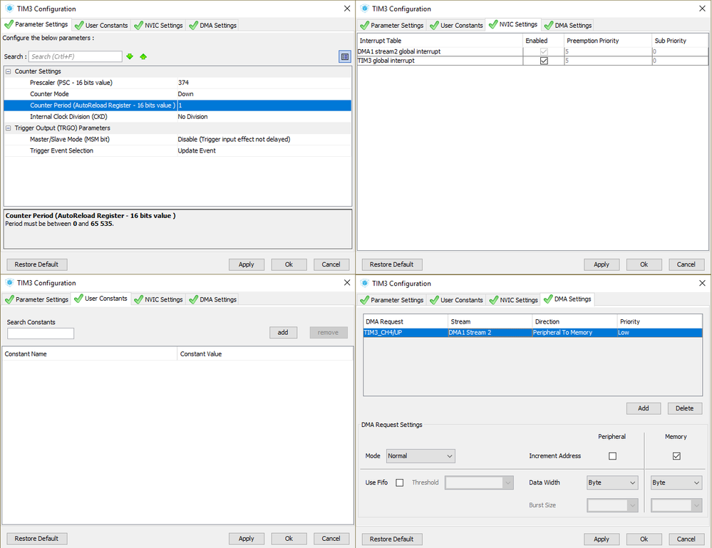

I have problem only with that:
  • How to set up prescaler and counter period for Timer corectly for this scenario?

You have set the ADC to trigger from TIM3_TRGO and TIM3_TRGO is set to be sourced from Update event, so it's the TIM3 "overflow" rate which triggers the ADC. In other words, the timer input clock (which is the timer-respective APB or APB/2 depending on your APB divider setting) gets divided by (PSC+1)*(ARR+1), so set them so that they produce a complete timer period matching your desired ADC triggering rate.
The half- and full- buffer interrupt is a property of DMA so it's about setting the DMA2Stream0 global interrupt on the ADC tab and then processing appropriately whatever falls out from Cube/HAL machine at the DMA2/Stream0 interrupt callback.
I am not sure it's a good idea to enable ADC interrupts.
