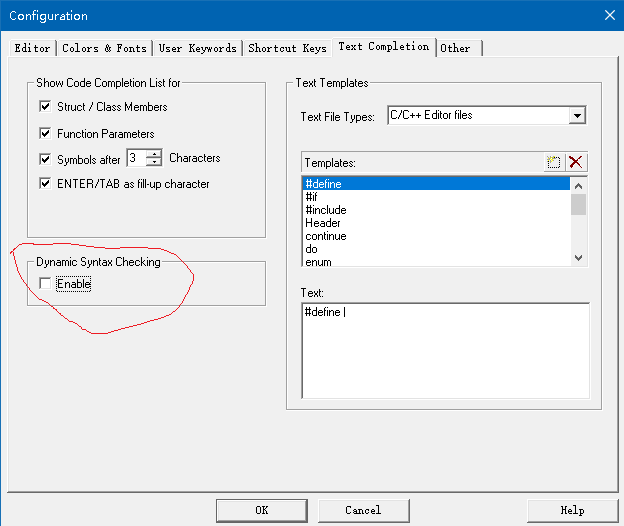

0690X00000DXMNtQAP.pngThere is a warning of __set_FAULTMASK(1) when using the STM32CubeMX5.5/5.6 to generate the code for the STM32F334, how to correct it. Thanks!

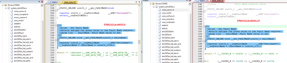

Which compiler? Keil?
Then it should be in .... /Drivers/CMSIS/Include/cmsis_armcc.h
hw.1
yes,the compiler is Keil 5.29. cmsis_armcc.h have the definion of it.
Migrate the project from STM32CubeMX4.27 to STM32CubeMX5.6 and regenerate the code, have the warning in the Keil.

thanks, in the kEIL   Edit→configuretion→Text Completion→Dynamic Syntax Checking ( cancel it )0690X00000DYLpAQAX.png
