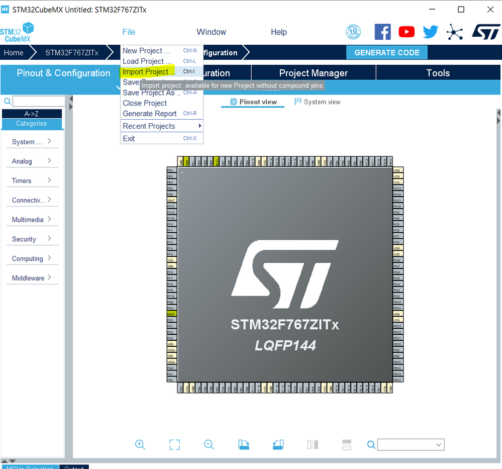

2020-10-21 4:36 AM
Hi @NW27
You can simply do the import of your project.Best regards,
Nesrine
