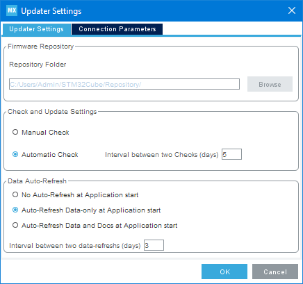

I have STM32CubeMX and STM32CubeIDE installed, but each use a different Firmware repositort folder.
So I have to download (with a slow ADSL line) and install twice every firmware package.
I want to install the package in a directory out of C:/users/Admin because I doesn't have the right to search in these directories.
The repository path and button is grayed in the Updater settings:
What can I do ?
Thanks.

Hello @Nikita91​ ,
The Repository Folder could not be changed while a project is open, to change it just after you opened the STM32CubeMX tool (help / updater settings) before creating you project.

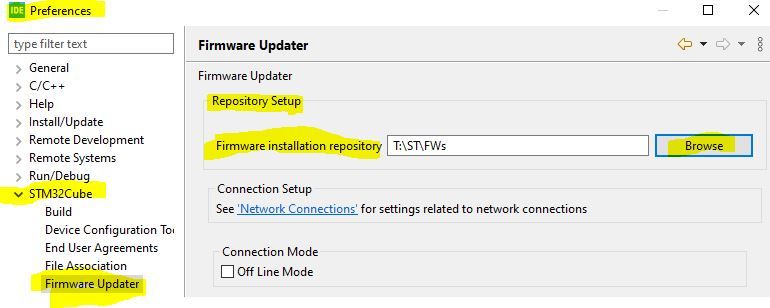

STM32CubeMX is allowing you to update firmware repository thru Help > Updater Settings.
Same is doable if STM32CubeIDE Thanks Windows > Preferences
Obviously you can point to same shared folder. Good pratice would be to avoid any special or blank char within such path.
