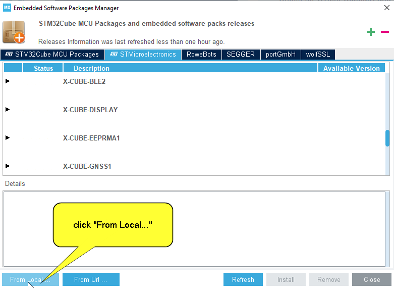

How can I install and use X-CUBE-EEPROM middleware in STM32CubeIDE ?
I am using STM32CubeIDE_v1.9.0 and  STM32CubeMX version 6.5.0
I would like to use the X-CUBE-EEPROM product

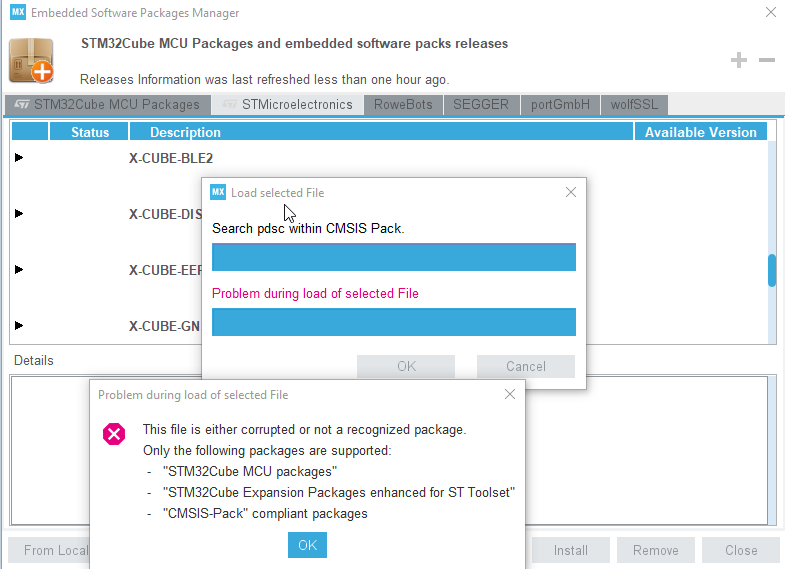

Here is the message I get when I try to manually install the downloaded expansion pack (from this link) using the Embedded Software Packages Manager and the From Local... Button:
What can I do?
Peter BENSCH
Peter BENSCHBest answer
March 14, 2022
OK, but unfortunately, you are confusing the terms a bit here and you will probably only understand this if you delve a little into the history: CUBE packages were made available long before the introduction of the free GUI STM32CubeIDE and could not be installed in STM32CubeMX at that time. However, it was already quite easy to integrate the file structure of the CUBE package into one's own project, even those provided by external developers are often integrated in this way. Information on this can be found in UM2312, UM2385 and UM2388.
Newer CUBE packages from ST are then gradually made installable in CubeMX/IDE.
By the way, the X-CUBE-EEPROM package also contains sample projects for several families, which you can import and test directly from the extracted file structure.
Hope I could help a little?
Regards
/Peter

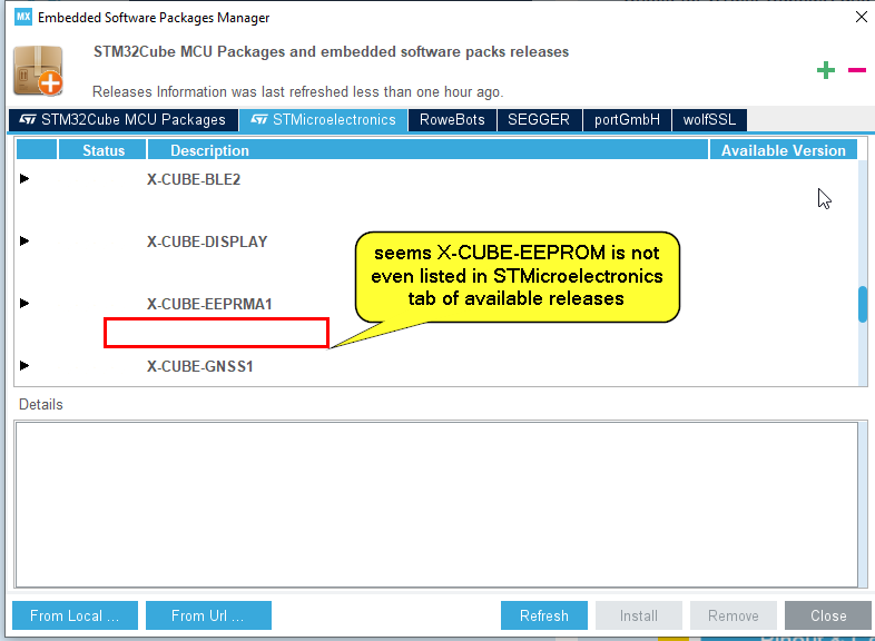

Tom MacDonald
March 12, 2022
I want to do eeprom emulation.
If MX-CUBE-EEPROM does not work with MX-CUBE then why does it have an "MX-CUBE" in the name?
Can you understand my confusion? If it's not an installable package for mxq then what is it?
EEPRMA driver is for working with external EEPROM chips as far as I can tell.
Which package should I install to STM cube32 IDE if I want to do EEPROM emulation using internal device Flash and how do I install the package?
