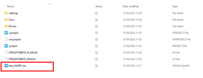

Hello @chris239955_stm1_stmicro_com
Could you please provide your IOC .
What is my IOC?
Go to your project folder and upload the file with the extension .ioc as shown in the screenshot.(example)
A ticket has been raised to the development team to further investigate this behavior.
Internal ticket number 208271 .
