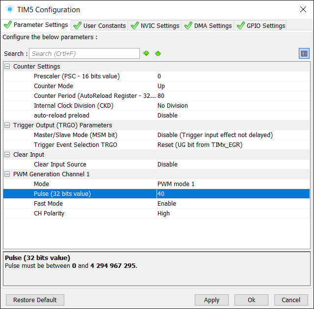

I made the most simple project for my stm32L476VGT:
- HSI (or MSI) speeded up to 80MHz through PLLCLK.

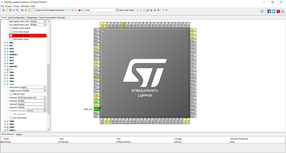

- TIM5 with PWM or CC on Channel 1
- PA0 on Alternate function (TIM5 ch5) with very high speed
Reference manual is saying that internal clock of the timer is APB (so 80MHz).

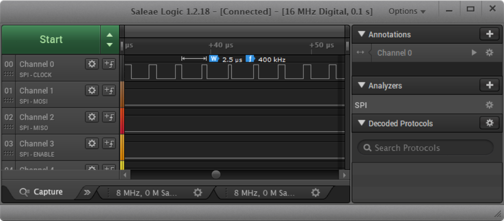

Despite of my differents trys, i don't managed to get an output signal at 20MHz.
With the example bellow i expected a signal at 80/80 = 1MHz but i only get 400kHz...

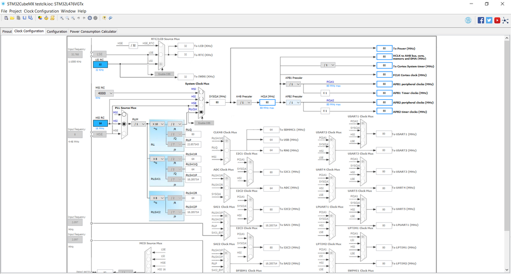

Hi Felix,
As a workaround you can use the LL driver for the RCC, the PLLM will be then well configured.
This issue has been fixed and will be delivered in the next release.

4.25.1 fixing this issue will be available by the end of this week
