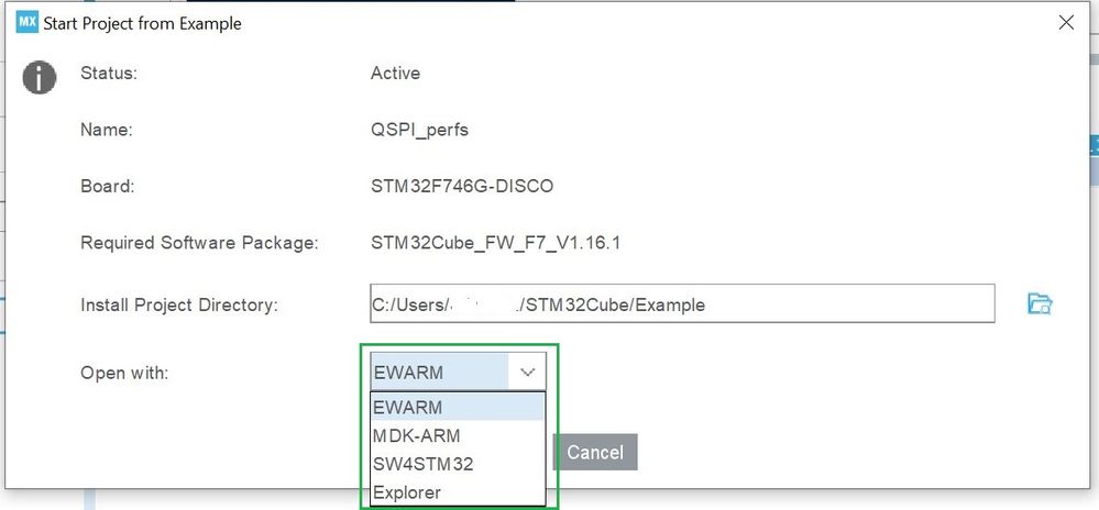

Some of the examples are not STM32CubeMX compatible (which is the case of QSPI_perfs, STemWin and TouchGFX examples). When selecting one those examples, you can only start your project in an external IDE:
Clicking the Start project in External IDE button, STM32CubeMX allows you to open the newly created project either with:
  • a File explorer
  • one of the supported toolchains (provided the toolchain is already installed on your computer)
0693W00000AMlDpQAL.jpgFor more details about the STM32CubeMX features, you can refer to its User Manual.

I have the CubeIDE 6.2.0 installed with software package FW_F7_V1.16.0 for my STM32F746/Disco board.
When CubeMX asks the IDE to export to CubeIDE is not listed. I installed CubeIDE 1.6.0 after CubeMX.
The options for Export Project or Start Project in External IDE.
EWARM
MDK-ARM
SW4STM32
Explorer
EWARM
MDK-ARM
SW4STM32
Explorer

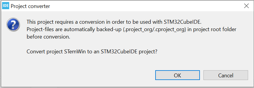

That's true CubeIDE is not listed within the available IDE list but if you select SW4STM32, STM32CubeIDE workspace will be launched automatically and a dialog box asking to confirm the migration of the project from System Workbench to STM32CubeIDE will be displayed:

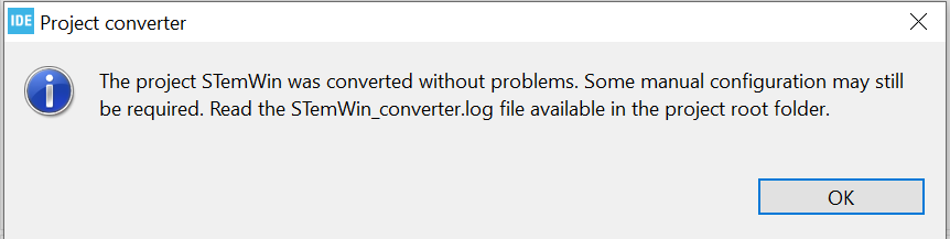

0693W00000AMsRjQAL.pngFurther on, another dialog box informs that the import was successful and that some manual configuration may be required:
Trying with the STemWin example, everything works right and the build finished without problems.
