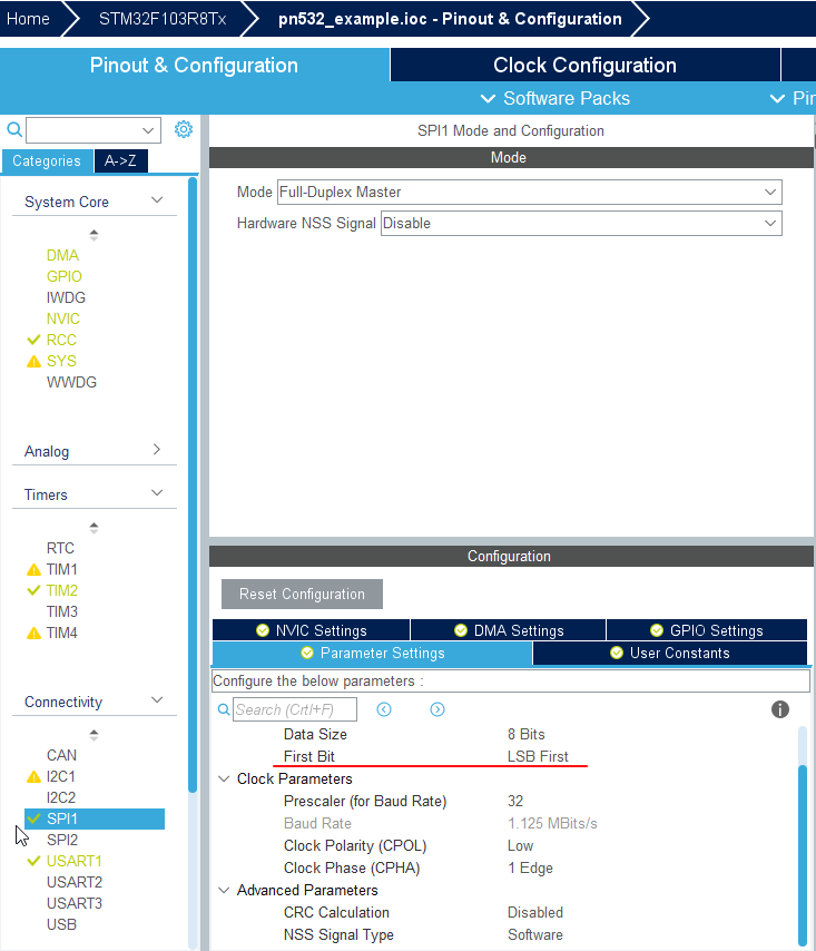

I setup SPI using CubeMX and set First Bit as LSB First as described in the datasheet.
0693W000005BOJEQA4.pngI thought setting this will handle LSB data by itself however it is not working as expected.
Below code only work with _SPI_HARDWARE_LSB defined which means I have to manually realign all the data in the buffer when transmitting through HAL_SPI function.
Is this is known issue or is how LSB suppose to be handled?

The hardware probably works. Put together a simpler example that strips possibly faulty logic from your program. Verify that SPIx_CR1_LSBFIRST is as expected.
