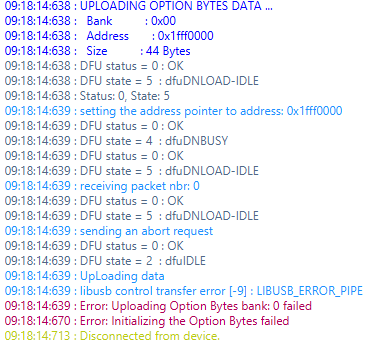

we have issues with USB DFU where we use the PC port. I uploaded two log files: one from CubeProgrammer and one from USB log in .txt (Wireshark).
Depended the on the USB port I am using USB DFU works. From PC seems DFU is looping while using the Dock USB port everything works fine.
10:38:05:230 : Error: Uploading Option Bytes bank: 0 failed
10:38:05:245 : Error: Initializing the Option Bytes failed
Also, is sending abort request common used to get in dfuIDLE state, or is this something wrong.

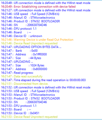

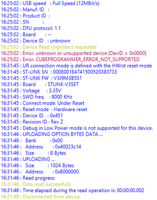

We use VBUS detect to select the boot configuration as USB DFU ones USB is plugged in at start-up. So we ignore the bootpin to automate DFU.

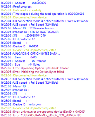

When connecting with "Read Unprotect", it cannot (sometimes it does) upload/read its DeviceID and OptionBytes.
It seems something to do with unsynchronized state machines of the internal F7 bootloader and CubeProgrammer.
The system seems to be quite unstable.

Example with USB FS with issue device ID
Issue with option bytes and device ID.
JB98
it has something to do with LIBUSB_ERROR_PIPE. Could not find sufficient info about this. If somebody can provide this would be nice.
