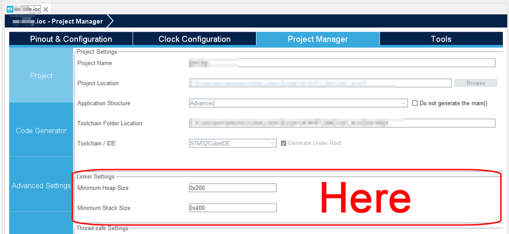

So how about adding a "noinit section" option in the Project 'Linker Settings':
Or making the generated linker script have areas which will not get overwritten - as in the generated 'C' code.

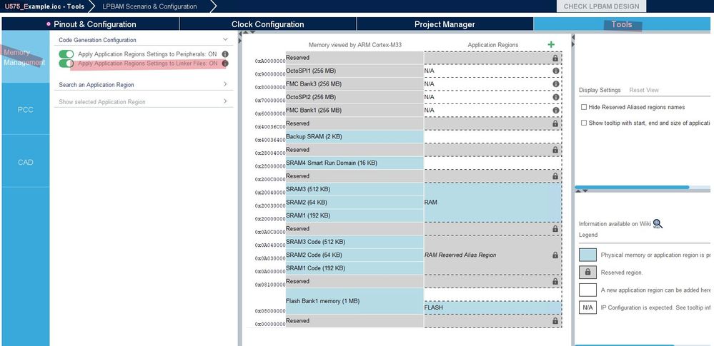

For the newer STM32U5 family (at least), they seem to be moving in that direction:

This is for cortex M33 to configure secure and non secure regions.
But for all STM32 should be posibility to define memory regions, and sections.
In CMSIS startups  provide posobility to initialize or clearing multiple sections.  It not hard do generate proper linker script  from MX.

My point is that ST has already (for some families) implemented a GUI for editing memory sections that drives linker script generation - so what Andrew (or your own thread hijacking feature request) is asking for is a natural extension of something that already exists, not a complete rewrite of their flow.
