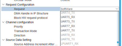

I can't enable DMA for USART6, in DMA handle list USART6 is not shown (STM32N6)
  • August 12, 2025
  • 235 views
I trying to use DMA on USART6, but in handle list USART6 is unavailable:
I ques what there is some CubeMX error because in stm xxx_hal_dma.h file this uart is added to list:
#define GPDMA1_REQUEST_USART6_RX 117U /*!< GPDMA1 HW request is USART6_RX */
#define GPDMA1_REQUEST_USART6_TX 118U /*!< GPDMA1 HW request is USART6_TX */
 For now I will try to setup manually, but I still on question about this issue ?

Hello @TheImmortal
Thank you for your valuable contribution.
The issue has been escalated to the development team for  resolution. The internal ticket number  is 215703.
I will keep you informed of any updates as they become available.

Hello @TheImmortal
This issue has been resolved in STM32CubeMX 6.16.0  also  the latest version of STM32CubeMX 6.17.0 is now available.
