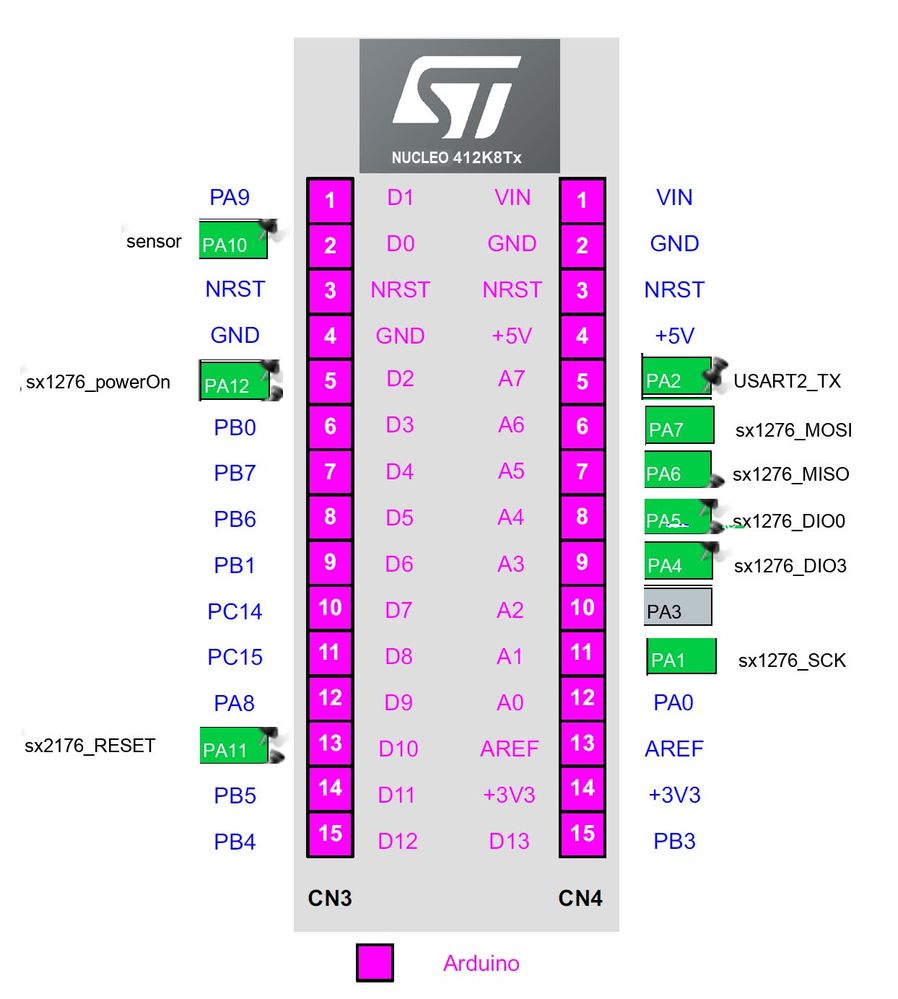

Currently cubeMx provides a pinout view usefull to see what is in use and to choose alternates
depending of board layout constraints.
Would it be possible to add an "eval board" view which would allow to see basically the same information but on a nucleo or any other compatible eval board.
Today, if I want to wire a nucleo board from a cubemx configuration, I need to look, at cubeMx,
look at nucleo datasheet, found the the pin I'm looking in the 64 or more available (remember that they are not sorted on the CNx connectors). It's long and error prone.
Add that if I'm using a nucleo32 :
PA0 is on pin A0
PA1 is on pin A1
PA2 is on pin A3
and so on.
That's another reason for a mistake.
Something like this:
would be very usefull imho.
Thanks
Julien

Your request : To add a board view (otherwise correct me )
2020-04-01 5:50 AM
Yes,
today : pinout view / system view
tomorrow : pinout view / system view / board view (with the ability to choose a board compatible with the current MCU.
