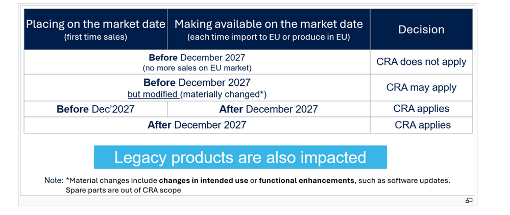

https://wiki.st.com/stm32mcu/wiki/Security:Deep_dive_on_CRA
For products placed on the market (1st sales) and made available on the market (after the CRA effective date),  -  really confusing terms - those products need to complay with CRA. the would mean if you have already released project that won't change but is still sold (imports), the SBOM is needed., But there is no SBOM xml data for these products  now (i.e F4). Even the products is not Class I, II or III,  still a self assessment is required.
How to generate this SBOM from existing projects ?
