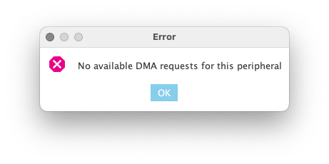

i am bit flabbergasted to find that it became impossible to selected DMA channels for I2S.  when i try to select a DMA channel for I2S peripheral the IDE responds with a scruffy "No available DMA requests for this peripheral"

Hi @gbiz​,
First let me apologize for the inconvenience that this regression may cause . As already mentioned, this issue was reported internally to be fixed as soon as possible.
I can assure that the fix will be available in a near future release. I'll surely keep you posted with the updates.
Meanwhile, you can use the previous STM32CubeMX version 6.2.1 (STM32CubeIDE 1.6.1) with the correct behavior.

PS i can also confirm that DMA is still available in STM32CubeIDE 1.6.1 … hmmm.

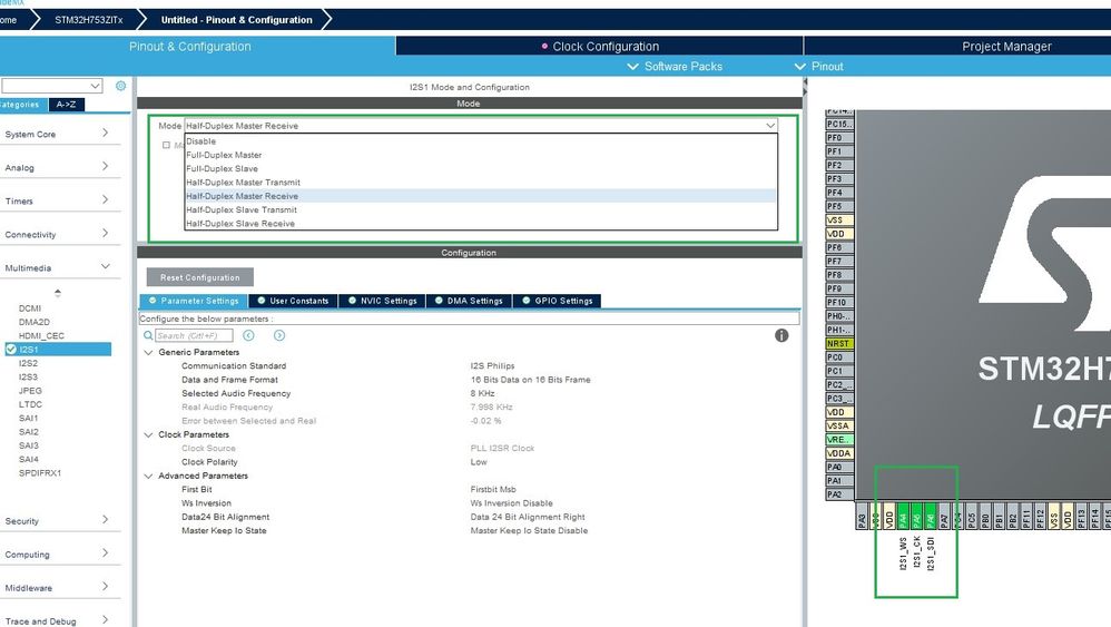

Per your advice, I just downgraded to 1.6.1 which gave me back the DMA option. Thanks! But there is another blocker issue here. When I select Half-Duplex Master Receive I2S1 on STM32H753ZI with version 1.7, it enables I2S1_SDI as the data pin. On the other hand, 1.6.1 enables I2S1-SDO, which is so confusing. Those are different physical pins with different data directions (input vs output). Which version uses the right one? I guess a Receiver should use an SDI pin, but I need to use 1.7 for that - still no DMA option. Could you please recommend a Cube IDE version which hadles both the DMA option and the correct data pin?

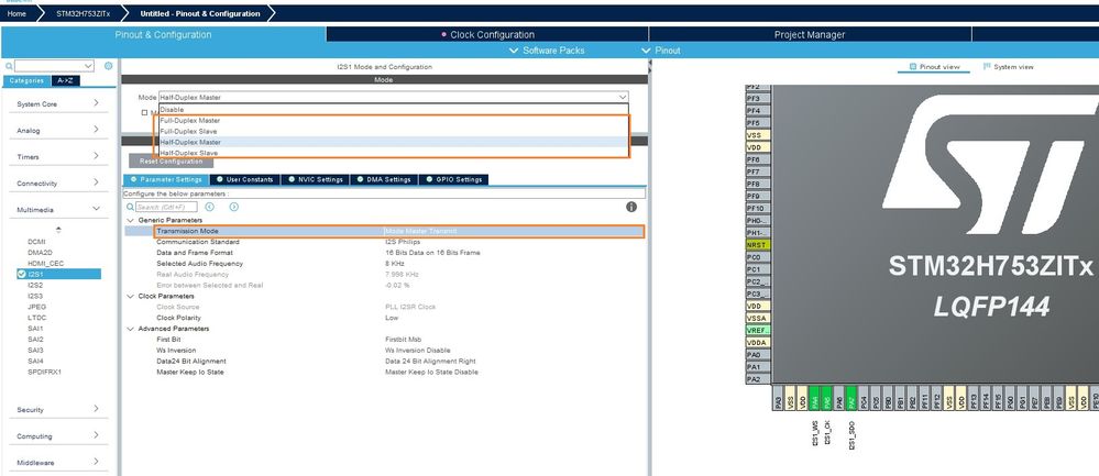

First let me apologize for the somewhat late reply. I can see your point, using STM32CubeMX version 6.2.1 there are only four available modes (which are Full Duplex Master/Slave and Half Duplex Master/Slave):
When configuring the "Half-Duplex Master" for I2S, STM32CubeMX enables by default "Mode Master Transmit" mode three pins:

Unfortunately even after changing the transmission mode to "Mode Master Receive", the pin configuration remains the same. This issue was detected and corrected in the latest CubeMX version 6.3.0 coming with six I2S1 Modes:
With this being said, next version of CubeMX will come with a fix for the DMA regression as well as the correct pin assignment. It will be available soon, I'll keep you posted with the updates.
