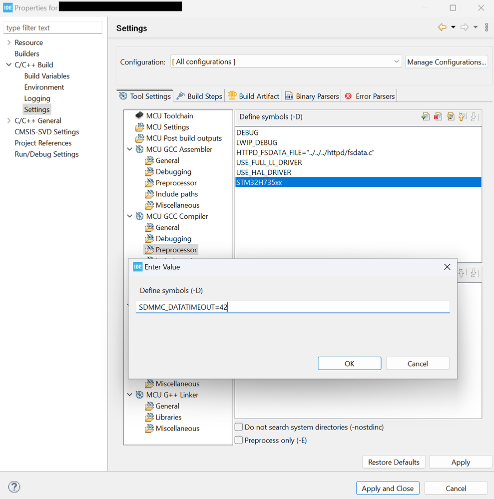

But in my case, even those are not sufficient. More specifically, I want to change two defines in the sdmmc low level header file (stm32h7xx_ll_sdmmc.h):
#ifndef SDMMC_DATATIMEOUT
#define SDMMC_DATATIMEOUT    ((uint32_t)12345)
#define SDMMC_CMDTIMEOUT     ((uint32_t)6789)
For SDMMC_DATATIMEOUT the #ifndef directive is provided so that the user can define the value beforehand. This seems like a good idea to prevent the need of custom user sections in those cases, but unfortunately this header (stm32h7xx_ll_sdmmc.h) is included (by the code generator) before the user defines that are set in CubeMX appear in main.h. The user section comment for the header-doc in main.h can be misused for this case though, but this makes some user defines via CubeMX obsolete.
For SDMMC_CMDTIMEOUT there is no way to change it via CubeMX, not even a workaround other than overwriting the generated files and taking care in future updates that the overwritten value does not get staged in git (or some other version control).
It's a little frustrating that there is no way to consistently handle changes for generated code in STs development environment.
You can simply add a global define to your build settings:define.png
For SDMMC_CMDTIMEOUT it is more challenging. One solution is to include the c file in another c file and exclude the original c file from build. Then you can add some macros at the beginning and end of the source code without modifying the file. Or simply make a copy of the c file and rename it and then exclude the original from build.
