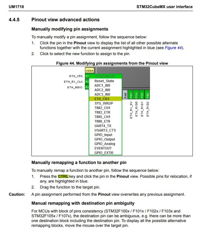

Cartu38 OpenDev
Lead II
Works like a charm for me if IDE 1.6.0 or MX 6.2.0 at least. I've just followed user manual:
0693W000008ySL4QAM.jpgOnly variation is on my side compliant target pins are all highlighted in black. Blue is allocated to pin I'm finally selecting to perform my remapping.
