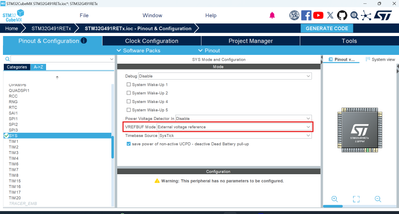

I am using STMCubeIDE with cubeMX, in that there is no such configuration for VREFBUF. is there any alternative way for that?
mƎALLEm
After checking, VREFBUF option is available under SYS menu.

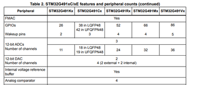

According to the datasheet STM32G491RET6 features an internal voltage reference buffer (VREFBUF)
It seems VREFBUF option is missing in CubeMx. I will escalate internally for analysis and eventual fix in the tool (internal ticket number 225569 for follow-up).
This thread will be closed.
