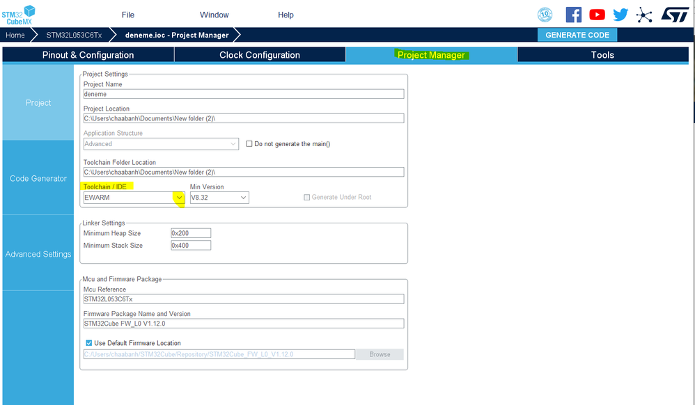

Hi @PBobo.1​ ,
In order to choose the Toolchain/IDE you can navigate to Project manager and you will find Toolchain/IDE.0693W000006G3uhQAC.png
Hope that this helps you ,
Thanks !

Hi @PBobo.1​ ,
Thanks !

I uninstalled Stm32CubeIDE and then installed it again. Again, nothing has changed. And in which version of the program were the screenshots that you provided?
My version of the program is missing the "GENERATE CODE" button in the upper right part of the screen.
