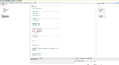

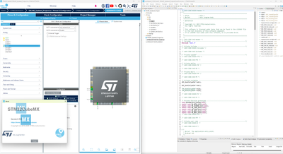

I have tested your IOC file, "DELME_Updated_Project.ioc," and, as shown in the screenshot, the generated code is correct.
Afterward, I configured additional peripherals (ADC1 and DAC), regenerated the code, and confirmed that everything is working as expected.

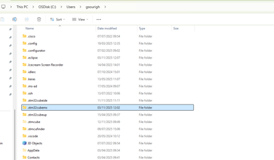

So I suggest that you close the CubeMX and then delete  the following folder .stm32cubemx  (On Windows: C:\Users\<YourUsername>\.stm32cubemx)
Then  Restart CubeMX and try again generate the code using your IOC  and make sure to use a new workspace
