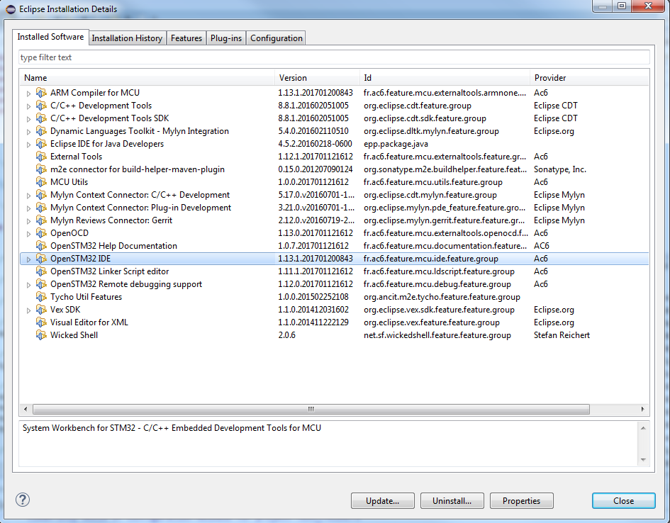

Posted on April 12, 2017 at 17:06
hello
Kim.Jisu
I understand your point however, I can't reproduce it. When I change the optimization level in SW4STM32/Eclipse, the paremeter value is kept even if the project is reloaded.
On my point of view, the parameter optimization level is a parameter from Eclipse that is not given by CubeMX.
I wonder what arethe versions of your openSTM32IDE and ARM Compiler for MCU in Eclipse:
I have these versions :
If you don't have the version 1.1.201701200843, please upgrade it and keep me informed if you still have the issue or not.
BR. Eric

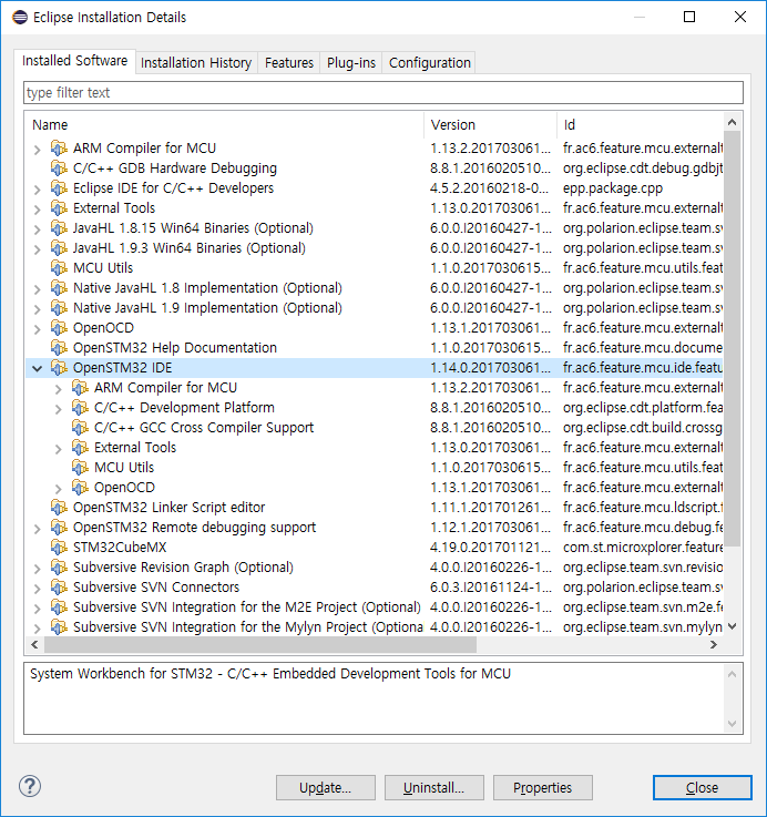

Posted on April 12, 2017 at 17:36
Hello
Joly.Jeanne
Thank you for replying. My OpenSTM32IDE and ARM Compiler for MCU version is like below.
- OpenSTM32IDE : 1.0.201703061529
- ARM Compiler for MCU : 1.2.201703061592
I did reinstall CubeMX v4.1 but it didn't work too. So I installed CubeMX v4.0 and it fixed my problem.
well, I don't know what was problem, but now goes well. That's weird...
here's my eclipse installation details.
Thank you!
