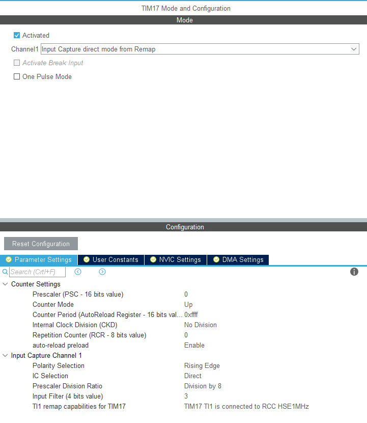

When I enable TIM16 and TIM17 for a project on the STM32H753ZI in CubeMX (version 5.6.1) and I select Input Capture direct mode from Remap, I can select TI1 remap capabilities (see picture below).
The generated code below is not correct. Line 17 calls HAL_TIMEx_RemapConfig() which is not suitable for this timer. The code should call HAL_TIMEx_TISelection(&htim17, TIM_TIM17_TI1_RCC_HSE1MHZ, TIM_CHANNEL_1) instead.

I've tested this for TIM16 and TIM17 which show the same behaviour.

Hi @rb1​
Could you please share your .ioc file to check the issue.

Hi @Nesrine.JLASSI​
Sure.

Hello @rb1​
Thanks for your feedback, issue confirmed, it will be internally fixed.
