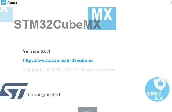

I am using cubeMX 6.6.1.
When selected FREERTOS cmsis-v2 and FATFS, everytime cubeMX generates code it oveerrides syscall.c with FREERTOS cmsis-v1 prototype funcions.

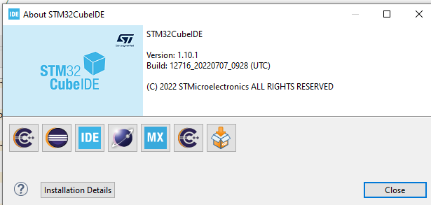

Good morning @Javier Muñoz
I recommend you to use stm32cubeide version 1.10.1
It is the latest version and your problem will be resolved
This is the link to download the latest version that i told you about
https://www.st.com/en/development-tools/stm32cubeide.html
Ghofrane
‎2022-08-24 1:13 AM
I dont think CubeIDE is the problem here, anyway, ill download the latest version and get back to you.

@Ghofrane GSOURI​ I just downloaded the 1.10.1 CUbeIDE
And as i expected ,the issue is still there, this has nothing to do with the Cube IDE,
Same thing could be detected using a plain text editor.
When generating the boiler plate code wth CUBEMX , when freertosv2 is selected, CUBEMX uses old freertos v1 function definitions in syscall.c causing this error.
