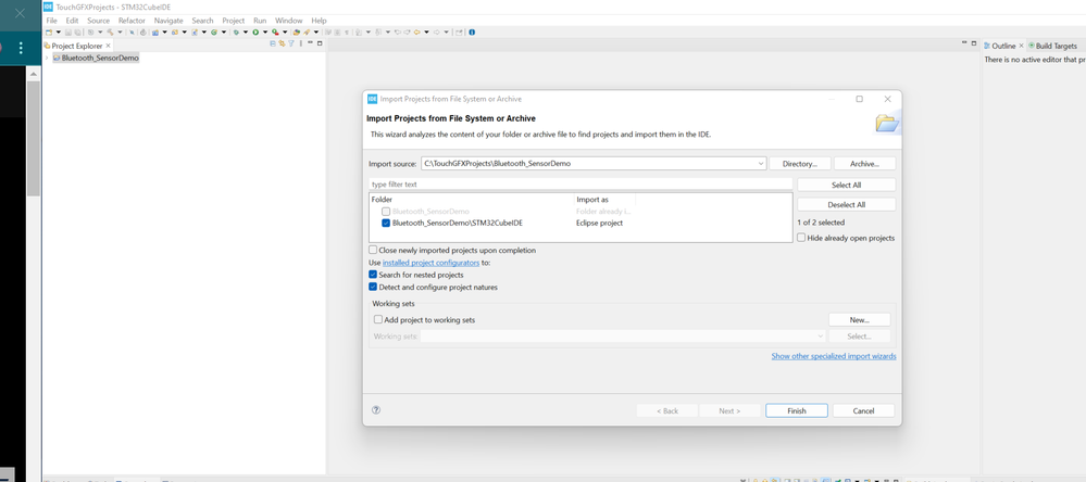

Additionally, when I try to import the project from the File System or Archive, it shows the Bluetooth_SensorDemo\STM32CubeIDE Exlipse Project is not opened. If I select it and hit finish, it does not do anything.
Does anyone know what causes this?

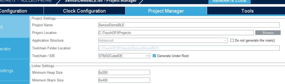

I found the solution.
I recreated the project, but when selecting the Toolchain/IDE when the project is first generated, you have to select the "Generate Under Root" option.
I did that and I could compile/run it.
I consider this resolved, but does anyone understand why that would matter?

Hi @KMew​,
You should check this checkbox in order to generate the toolchain project files in STM32CubeMX user project root folder. This option allows to benefit from the Eclipse features such as copy of the project into the Eclipse workspace when importing a project or use of source control systems (GIT, SVN,...) from the Eclipse workspace.
