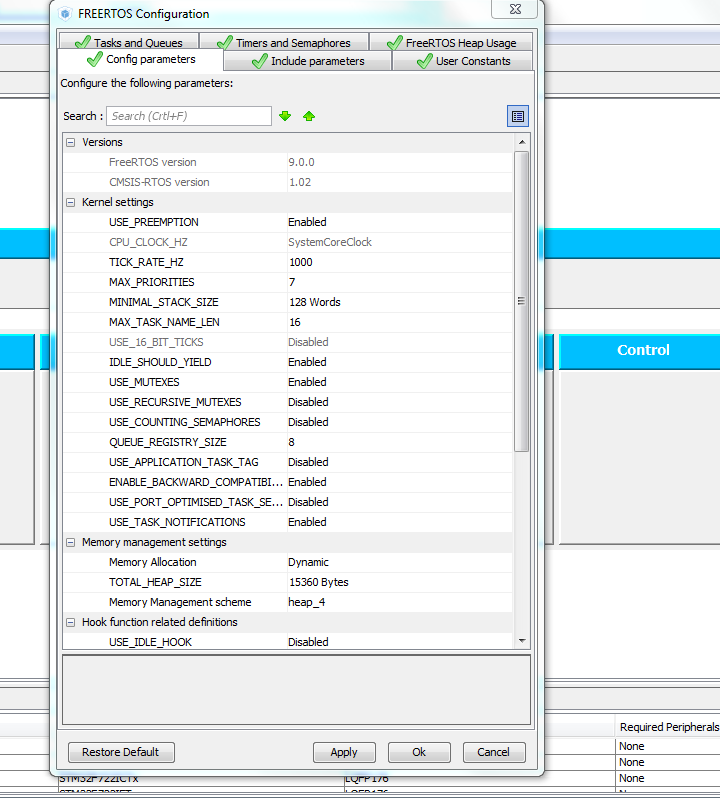

Posted on February 01, 2017 at 16:15
In the last CubeMX version (4.19) the USE_TICKLESS_IDLE option is missing. This disables the configUSE_TICKLESS_IDLE flag and the low power configuration.
Is it a bug? Is any workaround available?
PS: I've checked the 4.17 version and it has this option available. I don't have the 4.18, so I can't check it.
#cubemx #freertos #cubemx-4.19

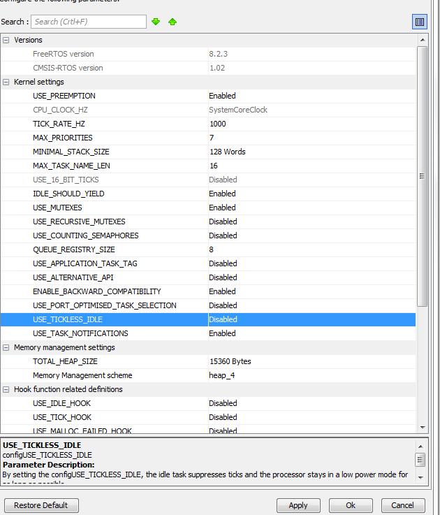

February 2, 2017
Posted on February 02, 2017 at 12:55
Dear User,
Please go the Config parameters tab.
In the Search field enter TICKLESS, you will be directly pointed to the USE_TICKLESS_IDLE parameter.
See attached snapshot.
________________
Attachments :
FreeRTOS_UseTickless.png : https://st--c.eu10.content.force.com/sfc/dist/version/download/?oid=00Db0000000YtG6&ids=0680X000006Hyxm&d=%2Fa%2F0X0000000bET%2Faw2LTXhjjnIzs.32Xbwp82T55vKoaNxkMo3r9e98Bfc&asPdf=false

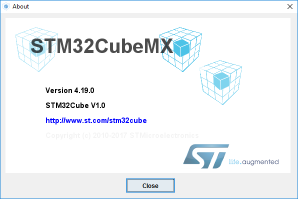

Aaron Pica
February 2, 2017
Posted on February 02, 2017 at 13:08
Hi
Mondoloni.Pascal
I'm sorry, but this is not true in the last version (4.19).
Are you using the last CubeMx version?
Thank you

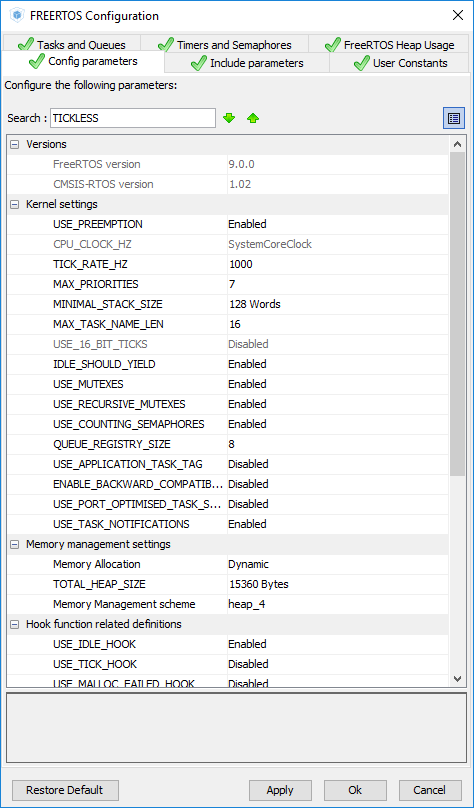

February 2, 2017
Posted on February 02, 2017 at 13:57
Hi pica.aaron,
This is depends on FreeRTOS version and not CubeMx version:
USE_TICKLESS_IDLE flag is
available with FreeRTOS version 8.2.3, but not in FreeRTOS 9.0.0
FCR
