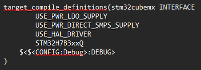

It is defining both USE_PWR_LDO_SUPPLY and USE_PWR_DIRECT_SMPS_SUPPLY  in the generated CMake file.  It should only define USE_PWR_DIRECT_SMPS_SUPPLY since that's the selected power mode in CubeMX.  I believe this is just a bug with STM32CubeMX code generation.
If I bump your SYSCLK to 280 MHz (max value) the generated CMakeList.txt file only contains:
target_compile_definitions(stm32cubemx INTERFACE
	USE_HAL_DRIVER
	STM32H7B3xxQ
    $<$<CONFIG:Debug>:DEBUG>
It is confusing how and what the different options are.

Hello @cvanbeek
I Couldn't reproduce the issue with a new project starting from scratch but a ticket has been raised to dev team for further investigation to identify the root cause of this behavior (internal ticket number 197797 )

Hi @Ghofrane GSOURI,
Thank you for noting the issue.  Here's more info on my environment and the example I generated with this issue.
Environment:
  • Windows (we've reproduced this on Windows 10 and Windows 11)
  • STM32CubeMx version 6.13.0
  • STM32Cube FW_H7 V1.12.0
Steps to generate a project with the error:
  • Create a new project for STM32H7B3LIH6Q in CubeMX
  • Select 'No' when asked about configuring MPU
  • Give the project a name
  • Change the toolchain/IDE to 'CMake'
  • The RCC tab already has the supply set to PWR_DIRECT_SMPS_SUPPLY, so no change is needed there
  • Click 'Generate Code'
The resulting cmake/stm32cubemx/CMakeList.txt file has the incorrect USE_PWR_LDO_SUPPLY definition:
