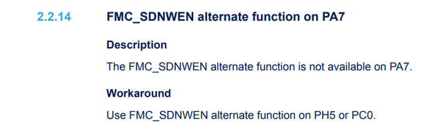

Issue resolved.
After reviewing the STM32F469 errata sheet, it was identified that PA7 does not support the FMC_SDNWEN alternate function. However, during code generation, PA7 was configured for FMC_SDNWEN, which was misleading.
After reconfiguring FMC_SDNWEN to a valid pin as mentioned in the errata sheet, the SDRAM started working correctly.
Attached the errata reference image for clarity.

Issue resolved.

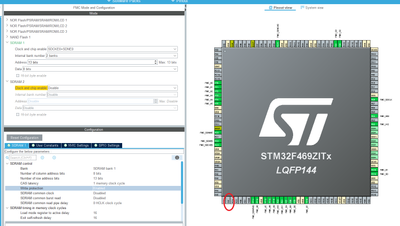

Thank you for the update.
Could you please share your ioc file on which PA7 is enabled for FMC_SDNWEN by CubeMx by default?
I am currently unable to share the .ioc file, but the issue can be reproduced with the following steps:
  1. Create a new project for STM32F469ZIT6.
  2. Enable SYS and RCC.
  3. Enable LTDC.
  4. Enable I2C1.
  5. Enable FMC.
After enabling FMC, PA7 gets assigned for FMC_SDNWE.
Thank you for the support.
You can share with me the ioc file in private. So we could analyze from our side.
When I've enabled the FMC_SDRAM, PA7 is not active:
