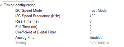

I have problems with the I2C frequency when I'm generating code with CubeMX 6.12.0 for the STM32U5A9. The timing register from the I2C3 is generated wrong, which leads to a frequency around 350kHz instead of selected 400kHz in FastMode operation.

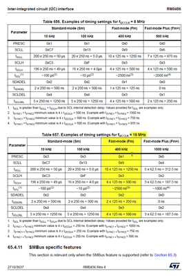

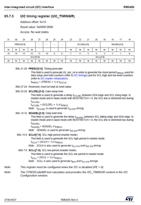

The tool generates 0x0010061A and regarding the datasheet example (see printscreens) it should generate something like 0x10320309.

What means exact, I would expect that is in the range of 400kHz and not more then 10% inexact.
I attached you the requested .ioc file.
