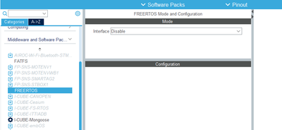

Dear @STea ,
I have opened the file which you shared with me .
Please find the attached screenshot for your reference.
In that FREERTOS option is enabled
Regards,
