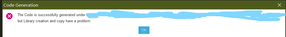

I re-installed the newest CubeMX 6.0.0 recently. But when I open my old projects which created with CubeMX 5.6.0 or earlier to open some TIM channels, it reported an error message:
The Code is sccessfully generated under {my path} , but Library creation and copy have a problem.
At first I thought that it wouldn't make any differences though it reported error, but after I flashed it the mcu didn't run as normal as before even I HAVE NOT CHANGE any code except what the CubeMX did.

​1�?Do not have Chinese characters in the file save path
2�?Copy the STMCX file into a new folder and regenerate the code
