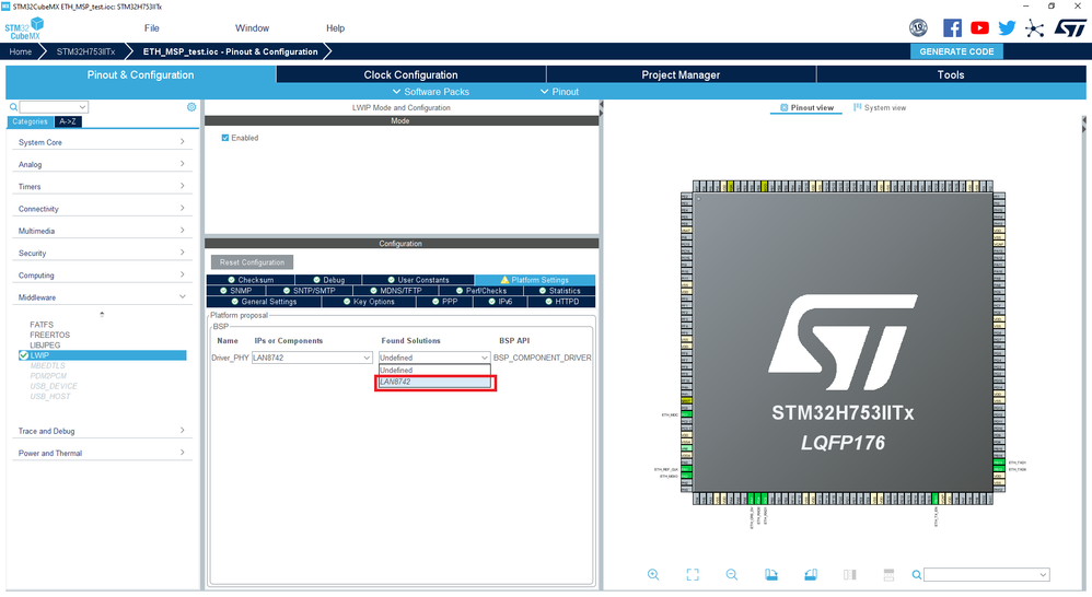

Problem with generating initialization code for ETH. After updating my project written in CubeIDE 1.8.0 and CubeH7 1.9.1 do Cube IDE 1.9.0 and CubeH7 1.10.0 Ethernet stopped working. After short investigation I find out that CubeMX does not generated HAL_ETH_MspInit, this is part where GPIO is configured. When I added missing functions from previous version everything start to work. I also tried to generate new project and it still miss HAL_ETH_MspInit.
Is it known issue?

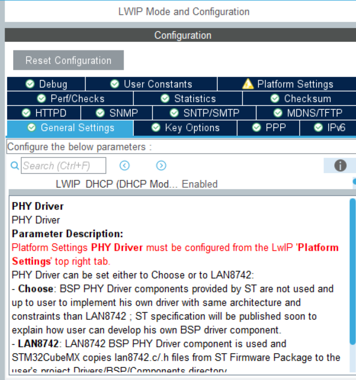

Sara BEN HADJ YAHYA
Hello @Sokolowski.Tomasz​ ,
It turns out that it is mandatory to set the BSP component in Platform Settings as explained in the "General Settings" tab of LwIP. By leaving it "Undefined", HAL_ETH_MspInit() will not be generated which is a normal behavior and not an issue since the LwIP is not completely configured.
0693W00000Nr9pGQAR.pngSara.

Sara BEN HADJ YAHYA
You are right, I see the issue now. It seems that the HAL_ETH_MspInit() doesn't get generated in ethernetif.c file when LAN8742 is not selected as a solution in LWIP Platform settings in CubeMX UI.
I submitted a ticket to the dev team to fix this issue. I will keep you posted.
Internal ticket number: 129696 (This is an internal tracking number and is not accessible or usable by customers).
In the meantime, I advice you to change the solution from Undefined to LAN8742. By doing this, HAL_ETH_MspInit() will get generated correctly.
0693W00000Nr6m9QAB.pngI hope this helps !
If your issue is solved, please close this post by clicking the "Select as Best" button. This will help other members of the community find this response more quickly :)
Sara.

Sara BEN HADJ YAHYA
