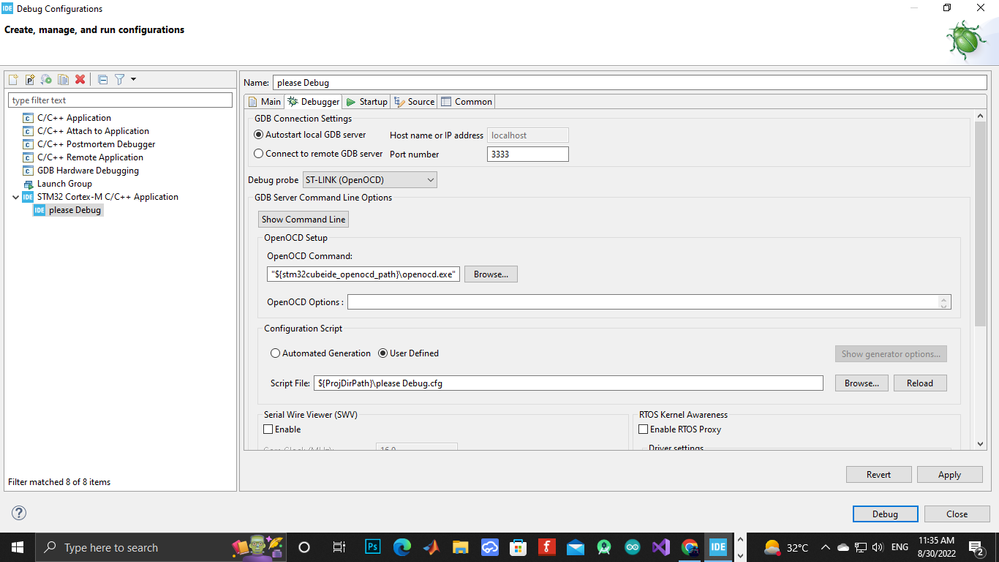

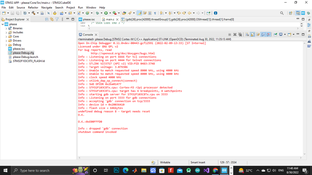

i cant uplode code in my stm32 Bluepill. error notification (could not verify ST device).
how to solve this problem 0693W00000Su358QAB.png 0693W00000Su34jQAB.png0693W00000Su34ZQAR.pngI also change change stm32fx.cfg file .but I face same problem .

Welcome, @SAHME.1​, to the community!
The topic has already been discussed here several times (e.g. here:( the Bluepill have not contained original components for a long time, but counterfeits that behave quite differently. Therefore, the message "Could not verify ST device" may well be correct.

Thank you for your comment brother , is there any way to code bluepill use st-link on cube ide
Peter BENSCH
ST provides tools (STM32CubeMX, STM32CubeIDE, etc) for their products free of charge.
Can you give a reason why ST should also support components from other manufacturers or counterfeits with these tools?
