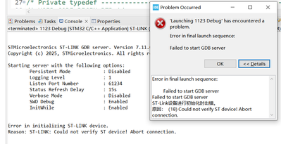

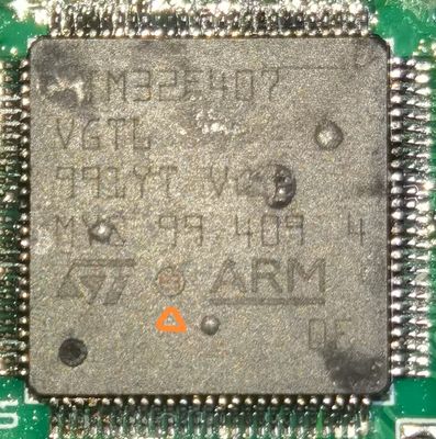

I have already updated my CubeIDE to the latest version 1.19.0 available on the official website. After writing the code with it, I attempted to download it to my F407VGT6 via STLink, but the download has never been successful. It always prompts "Could not verify ST device!" When I replaced one board with another, I was able to successfully download. The only difference between the two boards is that the silk-screening of the two VGT6s is slightly different. One has a small circle with "e3" inside and can be downloaded, while the one that cannot be downloaded has "e4" in the circle. I wonder if CubeIDE has not yet adapted to this chip. Has anyone encountered the same situation? I hope to get your solution!

Try connect with CubeProgrammer, to both, and show, what its telling (chip ID etc.).
Thank you. I have already modified the title. Yes, I'm using a custom board.
untitled__666
Visitor
OK, I have uploaded the screenshot of the fault code.

But actually, I don't think it's the problem of the board or the ST-LINK, because I have used the same ST-LINK and board for testing before. The only difference lies in the chip. When there is an "e3" silk-screen on the chip, it can be programmed; however, "e4" cannot.

The same board, the same ST-Link programmer, but some chips just can't be programmed. Are the chips fake?!
Based on the screenshots, seems like the programmer is to blame, probably a fake. Show a picture of your programmer.
That soldering looks pretty bad. Doesn't look like it was soldered flowed. I would double check to be sure there are no shorts.
