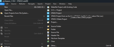

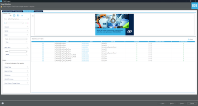

The easiest way is to use the example selector.
Go to File > New  > STM32 Project > Example Selector > Search for this example
