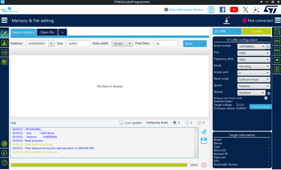

So show, pic, not error message - this is useless,  CubeProgrammer, to both, and show, what its telling (chip ID etc.).

using CubeProgrammer, then connect:
Is that so?

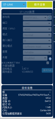

This is the information of the chip that cannot be burned.
So you get connected to the chip:
It's basically working ok,
And is F4xx type, good, so far.
Now try to flash a bin or hex file to the CPU.
If not possible, try doing mass erase, full chip erase , then try flashing.
If not possible,
check the option bytes, but be careful, not to activate rdp Levels, this would brick the chip. Just set all memory to not write protected. Then flash your program.

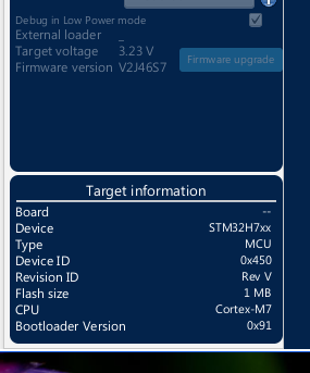

I tried to program the chip using Keil and it worked successfully. Then I tried to re-burn the program using the CubeIDE again, but it still failed. The program code is the same.
As @TDK  (and I) suggested earlier, this smells like a fake ST-Link and/or fake STM32.
You still haven't said what ST-Link you are using.
