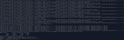

I have upgraded recently to STM32CubeMX 6.15 on Linux and regenerate code for my STM32G491RE project (that uses iostream). Since this, it gives me compilation errors on missing libc symbols (for example putwc).
After investigations, it seems the linker script generated has changed and I wonder if it is expected.

Sorry I have missed a lot of details.
First, I'm using STM32CubeMX v6.15 installed on XUbuntu 24.04.03. CMake is v3.28.3 and gcc v14.2 from arm.
I'm creating a new project in STM32CubeMX for Nucleo-G491RE board keeping all default options, then changes Toolchain/IDE to "CMake" and generate the code.
Then I can successfully build with:
  • cmake -DCMAKE_BUILD_TYPE=Debug -DCMAKE_TOOLCHAIN_FILE=cmake/gcc-arm-none-eabi.cmake -G "Unix Makefiles" -S . -B build/
  • cmake --build build
Then I'm adding C++ iostream usage:
  • I rename main.c into main.cpp (and update the CMakeLists.txt accordingly) to switch to C++
  • I add iostream usage in main.cpp:
    • #include <iostream> at the top
    • std::cout << "Test" << std::endl; somewhere in the main method
A rebuild now fails reporting undefined reference for putwc/getwc.
Then I change the linker script to end with the following extract (:* removed) and it solves the compilation failure:
