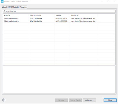

The latest version of STM32CubeMX is 6.15.0. Have you tried it?
BR, Souhaib
Hello Souhaib,
Thank you very much for the quick response.
I have checked the version of the integrated CubeMX engine within my STM32CubeIDE. I can confirm that I am already using the latest CubeMX version, 6.15.0, for this project configuration.
Despite using the latest available CubeMX configuration (6.15.0) and having confirmed all other settings (as detailed in my original post: correct include paths, FREERTOS_PLUS_INCLUDE_FREERTOS_H set, and C standard set to GNU11), the persistent FreeRTOS compilation errors remain.
This suggests the issue is likely not version-related but perhaps a deeper configuration conflict or a specific bug in how the H7 M7 core handles the FreeRTOS middleware package from the latest F7/H7 Firmware (currently H7 V1.12.1 is selected in my project).
Could you please advise on any other known workarounds for this specific combination of errors, or if there is a recommended setting outside the standard paths and preprocessor macros that might be required for the latest FreeRTOS headers on the STM32H7 M7 core?
