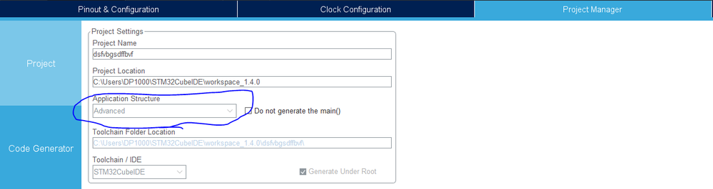

Hello, i cannot change Application Structure to Basic in STM32CubeIDE V 1.4.2

Hello FSere!
If you mean how to switch between flat and hierarchical project structure used for example in dual core projects then it's explained in the devices corresponding application note. For H7 devices, for example, it's explained in chapter 1.3.1 and can be found here: AN5361.
If I misunderstood your question then please provide some additional details about what the problem is and I'll look into it.
‎2020-09-16 3:59 AM
Hello Markus,
i was meaning the application Structure that is in the project manager in the .ioc file.
Sorry for not being detailed and for my bad english.
‎2020-09-16 4:37 AM
No worries! If it's easier for you then feel free to use another language and I can use google translate and hopefully still understand :smiling_face_with_smiling_eyes:
I'm not as knowledgeable about CubeMX (I'm in the CubeIDE team) but it seems that this is a known bug according to this thread.
It seems that you can use the stand-alone CubeMX tool to select Basic Application Structure and then generate a project for CubeIDE.
