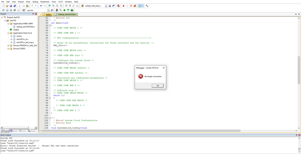

‎2024-01-07 5:21 PM - edited ‎2024-01-07 5:22 PM
this is how it looks like after uploading the code first time, the second time I cannot connect anymore.
Cube programmer says no STM32 target found.

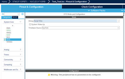

After analyzing the generated code, I found that the void HAL_MspInit(void) contains a call for a macro which set the GPIO debug pins according to the setting done in the CubeMX :
The screenshot shows the default stat which will make the CubeMX insert the following code in HAL_MspInit(void) which disable the SW debug
/** DISABLE: JTAG-DP Disabled and SW-DP Disabled
__HAL_AFIO_REMAP_SWJ_DISABLE();
To be able to make it debug correctly, you need to explicitly set the Debug settings in CubeMX (Case of SW with ST-Link)
/** NOJTAG: JTAG-DP Disabled and SW-DP Enabled
__HAL_AFIO_REMAP_SWJ_NOJTAG();
