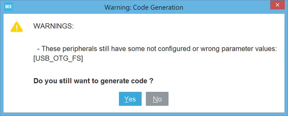

When I set up the USB_OTG_FS peripheral in CubeMX I get the following error:
Looking at CubeMX I can't see anything wrong.

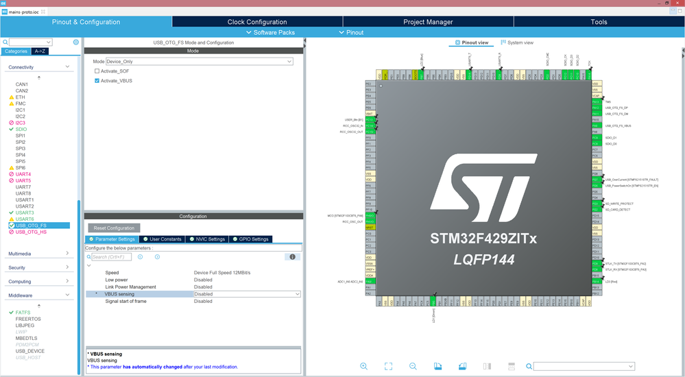

The only thing I noticed is that I can't enable VBUS Sensing. The only option is "disabled". It has a pin assigned for it, the box is ticked, but the drop down (highlighted above) only has "disabled" as the single option.
Edit: I should add that I have the correct 48MHz clock. This is the NUCLEO board.
Is the lack of VBUS detection the issue? The device is self powered. How can I figure out what the error message is referring to?

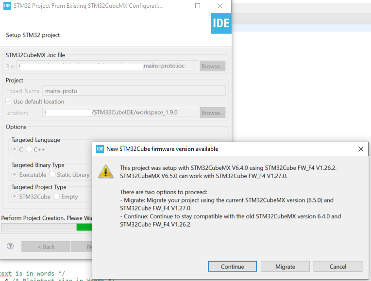

However, I can see that you're using an old STM32CubeMX/ STM32CubeIDE versions:
Can you please try with latest STM32CubeMX version ?

Normally when checking Activate_VBUS checkbox in USB_OTG_FS Mode panel, VBUS sensing will be set automatically to enabled and couldn't be disabled (only Enabled option is available).
It is a bit odd that you're setting Activate_VBUS and that VBUS sensing is always disabled (as far as I can see from the attached screenshots).
Could you please share your .ioc file for further check from my side.

Oddly I can't reproduce the issue from my side even starting the project based on your .ioc.
In fact, in the attached .ioc Activate_VBUS is unchecked and VBUS sensing is set t Disabled.
Setting Activate_VBUS will simultaneously enable VBUS sensing.

Thanks Khouloud, that fixed it. Should have tried that first. I didn't realize that the version of CubeMX was tied to the version of the support files for that MCU, I'm used to other IDEs where they always download the latest one.
