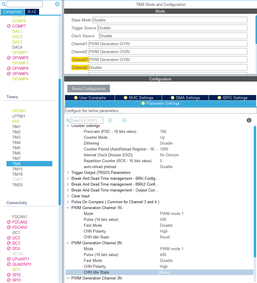

BUG: STM32G474 TIM8 outputs are floating when using the non negative output channels
  • August 29, 2019
  • 1 reply
  • 559 views
The outputs on TIMER8 of the STM32G474 are floating when using the non negative channels
This for the PWM or Compare options (PWM Generation CHx or Output Compare CHx)
When i use the negative channels everything works fine. (CHxN)
I used the following initialization code
HAL_TIM_Base_Start(&htim8);
 HAL_TIMEx_PWMN_Start(&htim8, TIM_CHANNEL_3 );
 HAL_TIMEx_PWMN_Start(&htim8, TIM_CHANNEL_2);
 HAL_TIMEx_PWMN_Start(&htim8, TIM_CHANNEL_1);
 STM32CubeMx 5.3.0 configured as follow (see picture)

Could be resolved as follow
 HAL_TIMEx_PWMN_Start(&htim8, TIM_CHANNEL_3);
 HAL_TIM_PWM_Start(&htim8, TIM_CHANNEL_2);
 HAL_TIM_PWM_Start(&htim8, TIM_CHANNEL_1);
