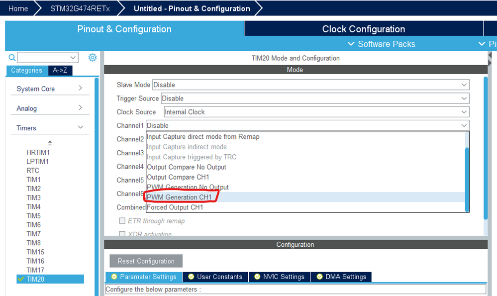

Am using STM32G474 in CubeIDE. Wanted to use TIM20 (Advanced Timer) Channel 1 in the PWM Generation CH1 CHN mode. This option is not available in the IDE. Am I missing something ? Environment: Nucleo-G474RE SM32CubeMX 6.0.1 STMCubeIDE 1.4.2

Works fine here. No pins for CH1N on the LQFP64 package.

Thanks. I didnt spot any pin alternative function for CH1N on TIM20 either. So the IDE behaviour is correct. In my opinion this leaves a good board with a crippled functionality.... :(
