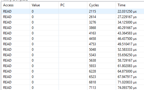

It only happens when there's an active transfer.
The OTG interrupt was called every 3...6uS (300-500 Core clocks @ 96MHz).
It seemed crazy excesive to me, that can't be correct!
Just to clarify: STM32F411, internal FS controller, cubeIde initialization, host mode (OTG).
Checking what interrupt flag was causing the calls, I found the culprit to be the SOF flag.
I put a small variable there and traced using SVW:
I have SOF disabled in CubeMX, however the code enables it anyway:
IDE: STM32Cube IDE v1.6.0
FILE: stm32f4xx_ll_usb.c
LINE: 1355
FUNCTION: HAL_StatusTypeDef USB_HostInit(USB_OTG_GlobalTypeDef *USBx, USB_OTG_CfgTypeDef cfg)
 USBx->GINTMSK |= (USB_OTG_GINTMSK_PRTIM      | USB_OTG_GINTMSK_HCIM | \
          USB_OTG_GINTMSK_SOFM       | USB_OTG_GINTSTS_DISCINT | \
          USB_OTG_GINTMSK_PXFRM_IISOOXFRM | USB_OTG_GINTMSK_WUIM);
Removing USB_OTG_GINTMSK_SOFM from the mask fixed the problem.
